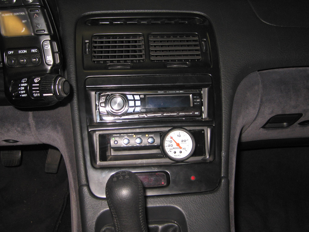

This set-up was "thrown together" for temporary use, since it's borrowed, but I thought it looked pretty good:

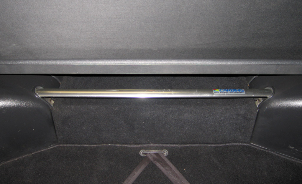

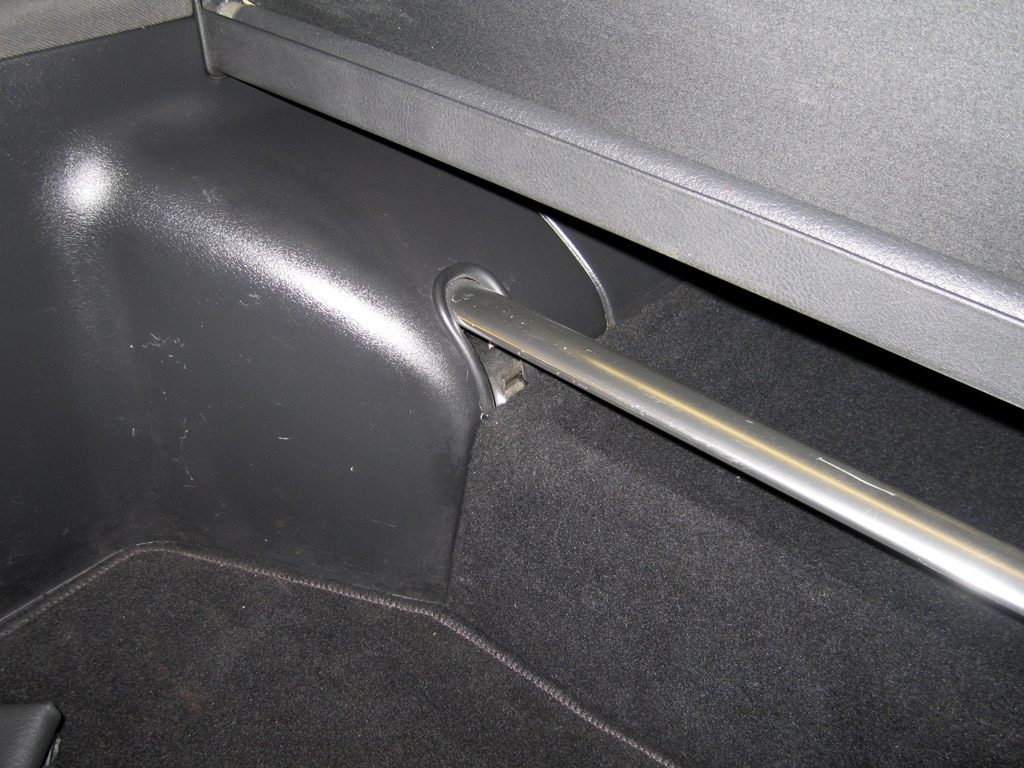

Very nice, clean Carbing bar install:
